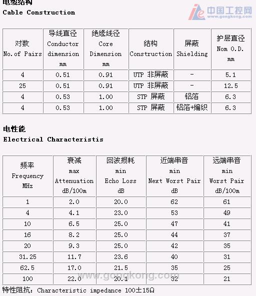

关于5类电缆的标准:
ANSI/TIA/EIA-568A
IEC61156-1994
ISO/IEC 11801(2nd edition)
CENELEC EN50173(2nd edition)
ANSI/NEMA WC63.1-1996
YD/T838-1996
