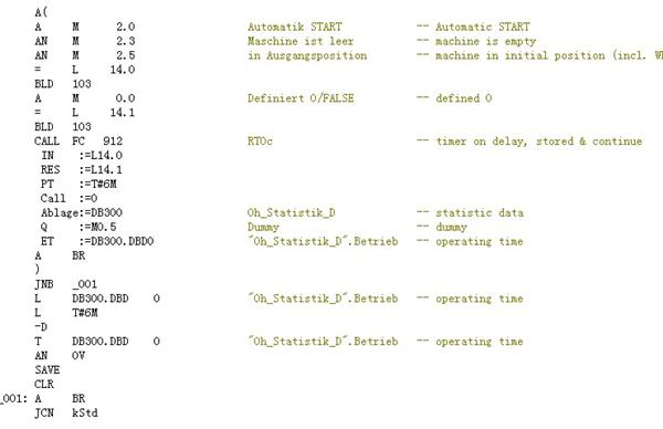

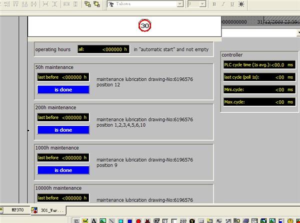

  今天看到一个 TX 计时的问题,后看我们设备也有维护保养时间计时,MP370上的程序如下图:
FC 300 statistic
FC912   timer on delay, store & continue
     OPN   #Ablage                     //open data DB
     L     #Call                       // Aufruf nummer
     SLD   5                           // ... x4 und ins Pointer-Format bringen
     LAR1                              //?address  make available
     A     #RES                        //reset ?
     JCN   m001                        // NEIN, -> Sprung !
     L     0                           //yes, delete
     T     DBD [AR1,P#0.0]             //?memory
     T     #ET                         //?display
     SET
     R     #Q                          //?result
     CLR
     SAVE
     BEU                               // und tsch黶s !
m001: A     #IN                         //time activ
     JCN   m002                        // NEIN, -> Sprung !
     L     T#24D                       // yes, maximum measuring range
     L     DBD [AR1,P#0.0]             //?load old time
     <=D                               //run off ?
     JC    m003                        // yes, further ! (VKE is 0)
     L     MW    96                    // no, time disalignment load
     +D                                //?add
     T     DBD [AR1,P#0.0]             //store new time
     L     #PT                         //load input time
     >=D                               //... compare
     TAK                               //?result reload
m003: =     #Q                          //spend result and
     T     #ET                         // ... anzeigen
     SAVE
     CLR
     BEU                               // und tsch黶s !
m002: L     DBD [AR1,P#0.0]             //?load old time
     SET
     R     #Q                          //卻et result to "0"
     CLR
     SAVE                              // und tsch黶s !
