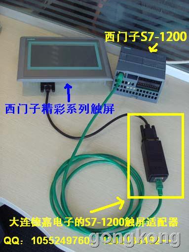

将西门子smart line (IE)触屏连接到S7-1200
